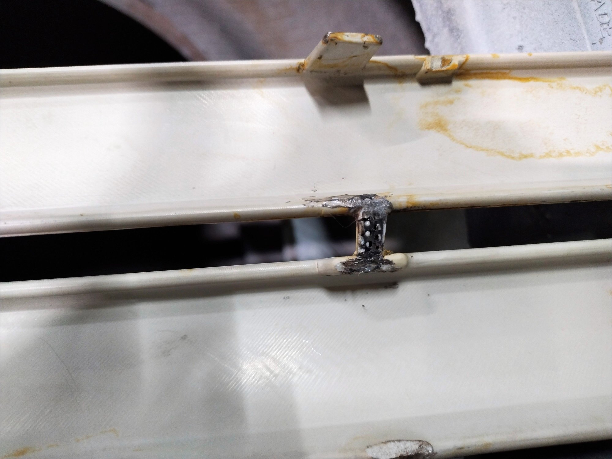

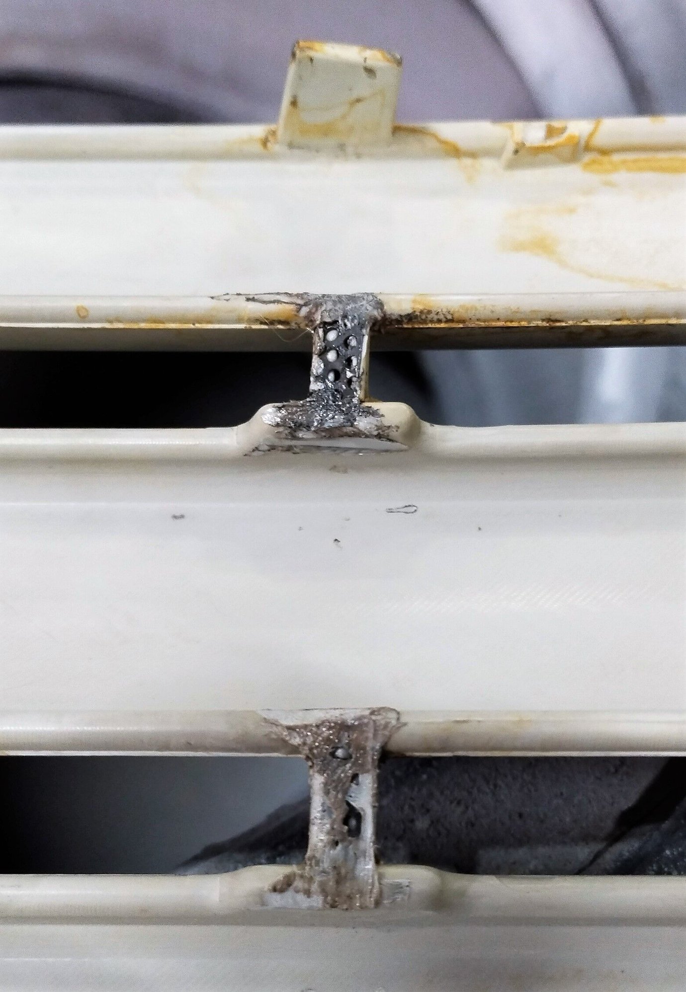

In general, I have a broken grille.
I bought another one in good condition. The old damaged grille... well, I can't throw it away. There is an opportunity for an experiment.
The first thing I decided to do was clean it from chrome so that I could paint the grille in the body color.

Here is the result. A bare grill for painting.
