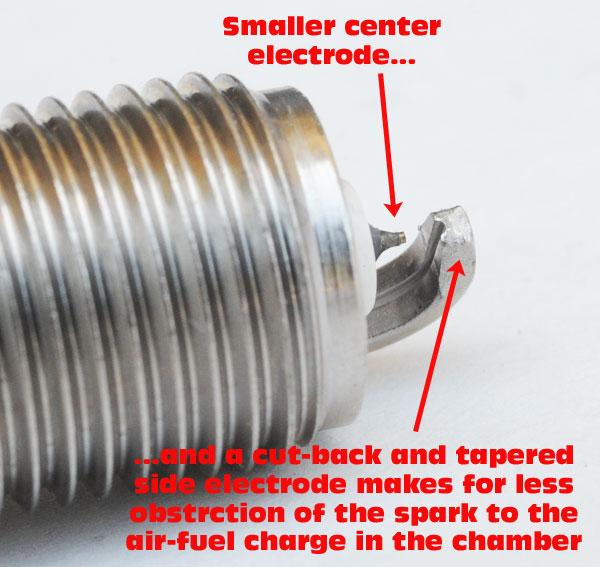

In my mind there are three chief advantages to the Denso Iridium Power spark plug, if the engine is subjected to regular high loads or a street high-performance or racing duty cycle: Cut-back, U-Grooved side electrode, the use of an iridium/rhodium alloy in the center electrode and the laser welding process used to assemble the plug.
What I think are the two chief advantages of the Denso
Forty years ago, Nippondenso (now just "Denso" and part of Toyota) patented the "U-Groove" ground electrode design. initially, the U-Groove was made famous with car enthusiasts in the U.S. by Accel, which has had Denso make its spark plugs for many years. In recent years, Denso sort of "re-launched" the U-Groove as an in-house design feature using the "Iridium Power" spark plug which incorporates the U-Groove as well as other performance-oriented features. The theory behind the U-Groove is that, just after the spark gets the air-fuel charge burning, it allows the flame kernel to fill the gap formed by the U-Groove. This develops a larger and hotter flash front which enhances combustion. The flat ground electrode design of ordinary spark plugs tends to "crush" the spark, inhibiting its growth. Engineers call that a “quenching effect” and it can degrade ignition effectiveness and, in extreme cases, cause misfire. The U-Groove feature results in enhanced combustion in the early stages of the process. While the U-Groove side electrode has its performance advantages, its original development was for improved ignitability, which can improve exhaust emissions and fuel consumption. The U-Groove giving the flame a "groove to grow in", enhances the ignition process, especial with a lean air-fuel ratio. With a plug having a conventional side electrode, the overall volume of the flash front can be smaller. One conventional method to improve firing of a plug with a flat side electrode was to increase the spark gap. This can detrimentally affect the spark if the ignition system is not powerful enough. With a U-Groove, ignition can be improved without increasing the spark gap.
To help improve ignitability, besides incorporating the U-Groove, the Iridium Power plug minimized the portion of the ground electrode which that comes in contact with the flame nucleus by tapering it and cutting it back slightly. Because the area of the ground electrode where the tapered cut comes into contact with the flame nucleus is small, the heat lost to the electrode is lessened and firing performance improves. The surface area and mass of the ground electrode tip is reduced along with the load in terms of heat and vibrations. This means the spark plug can cope with heavier driving conditions.
In the late-'90, Denso developed and patented an Iridium alloy which is superior to platinum in hardness, strength, melting point and electrical conductance. The new Iridium alloy is composed primarily of Iridium with rhodium mixed in for oxidation wear. Pure Iridium has a melting point of almost 1300°F higher than platinum, and had the greatest potential for resistances against wear. Iridium by itself is susceptible to oxidation wear at temperatures over 1650º and testing showed because of that, iridium alone would not meet Denso's durability standards. After testing several metals alloyed with Iridium, rhodium proved to be the best choice.
Additionally, the Denso Iridium alloy's better durability allows Iridium Power plugs to have what may be the smallest center electrode (.4mm) in the industry. Denso was able to shrink the surface area of the center electrode without it being destroyed by heat. A smaller center electrode reduces the plug's voltage requirement, ie: less energy is required from the ignition system to produce a given spark. Also, its smaller size, combined with the tapered U-Groove ground electrode, allows more space for the flame kernel to develop and produce more efficient combustion. Lastly, the .4-mm center electrode and the cutback, U-Groove side electrode exposes more of the air-fuel charge in the combustion chamber to the spark which further enhances the ignition process.
The tip of the IVT-20 which works well in a 2.4

I now have 126,000 miles on our HHR. I've been though two sets of Denso IVT-20s. The first set went 53634 miles and the second set went 51225 miles. In both cases, these plugs exceeded the manufacturer's advertised durability of 30000 miles. The factor determining replacement was the plug gaps opening up from .040-in to about .060-in. The vast majority of electrode erosion occurred with the ground electrode.
50K miles is outstanding durability for a high-performance spark plug such as the Denso Iridium Power design.
