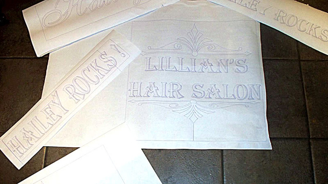

These are PAPER Templates, instead of a cutting blade in the Plotter/Cutter, you use a Pen or even a Sharpie. Then you use a pounce wheel following all the lines to poke tiny holes in the lines of the design, place the "Template" were you want it, and tap a chalk filled bag over it and that Transfers the design onto the side of a car, a hood, or a storefront window, then you can use paint, gold leaf, even to help place the vinyl it all depends on what your doing, but plenty of uses. Transferring your designs for airbrush work, possibilities are endless.
