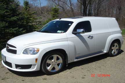

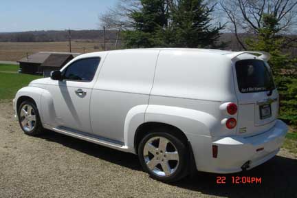

I did my '07 Panel. Many parts are involved to do it right.16 Parts.
All are at list price
(2) 10335108 SS fog lamps 112.63 Each
(1) 22714706 Deflector Under and behind bumper 58.51
(1) 25809912 SS Grille bezel (needs painted) 53.90
(1) 17801385 Protector, Deflector attaches to it. 50.80
(1) 25918728 SS Grille kit 113.85
(1) 22732491 Bowtie emblem 29.90
(1) 25809886 Rt fog lamp bezel 35.00
(1) 25809885 Lt fog lamp bezel 35.00
(1) 25809884 Lower grille 61.70
(1) 10370228 License bracket 13.81
(1) 25858225 Front bumper faschia (paint) 438.98
(1) 25809881 Extension (under car) 50.85
(1) 25809883 Front absorber 103.36
(1) 25809873 Rear absorber 69.49
(1) 25858226 Rear bumper faschia (paint) 438.98
Total parts 1779.39 plus local taxes
Plus paint labor and materials it is a pricey mod!

Don, the grille kit is the black plastic grille mesh part, the metal reinforcement at the bottom, the center brace and the rubber bumpers for the bottom.
The grille bezel is the surrounding plastic part that gets painted to match the car body. The bumpers need the absorbers behind them, because they are different than the standard HHR. You could skip the fog lights and bezels and the lower grille, but it would not look right.
