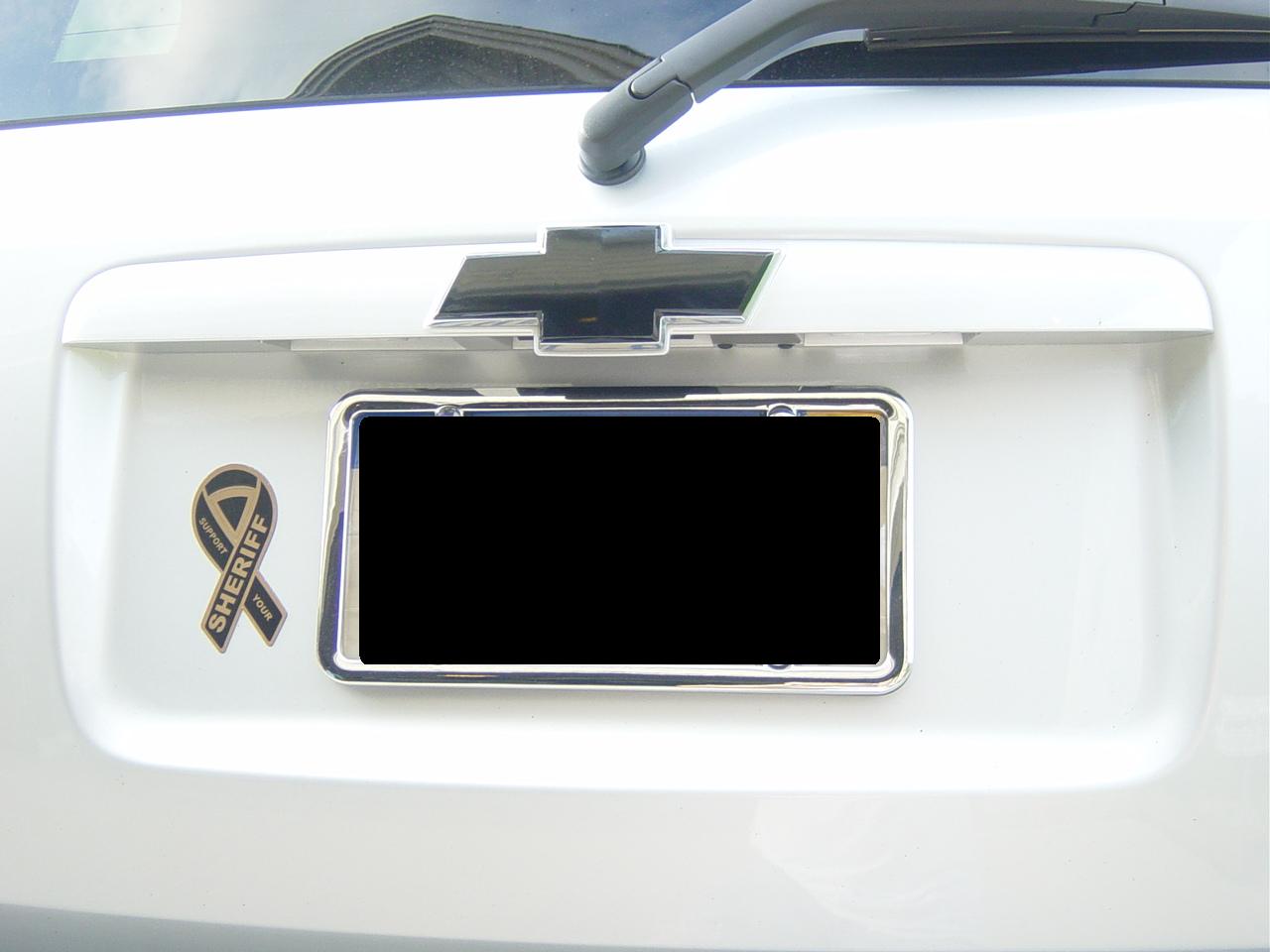

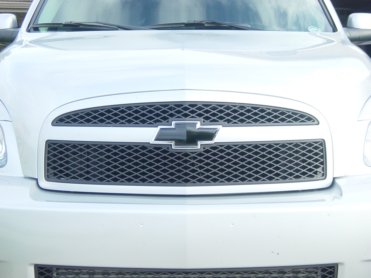

Could go the vynal way. A buddy of mine vynalled over mine. Took him about an hour to do both but they look good and the original gold badge is still under there. All you need is the correct color you want, put it over the emblem and trim around while pushing, rubbing, tucking, etc...
