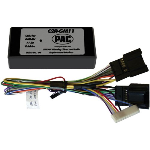

Got to figure out what to do about wire harness interface. I don't want to hook it up without one, but price jump was unexpected. May have to miss a few meals and live off my bag of Shakeology
Edit: Best Buy has the Scosche instock for $109. I couldnt bring myself to pay that. Did a google search and found out I was about to buy more than I needed. To retain OnStar is a higher price part. My LS didn't come with OnStar or XM. Found Pac C2RGM11 on Amazon for $68 and ordered it. With next day shipping its still cheaper than the Scosche. So I should be able to install tomorrow evening or Saturday IF the mounting adaptor trim arrives and I find a warm garage.
Pac C2RGM11 REPL Rdio CHM 06-07 GM LAN No Onstar
Data-controlled RAP accessory output. Antenna or amplifier turn on output wire. Dimmer or illumination output wire. Steering wheel control output ...
Amazon.com - $67.99
