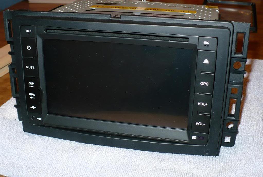

6.2" touch, GPS, DVD,.... Ordered today

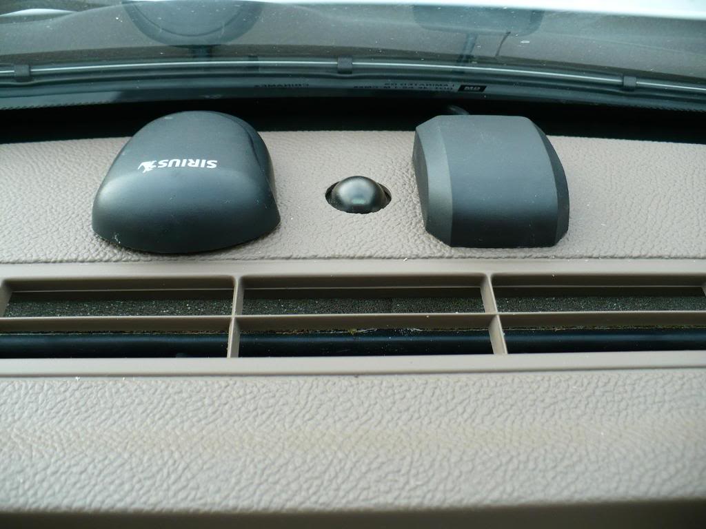

Dremmel out an opening in the back of the dash for the harness and GPS antenna connector to clear. Decided it didn't look like much to take the top dash cover off so I could run the GPS ant and the Sirrus ant up next to the glass and have all wires hidden.

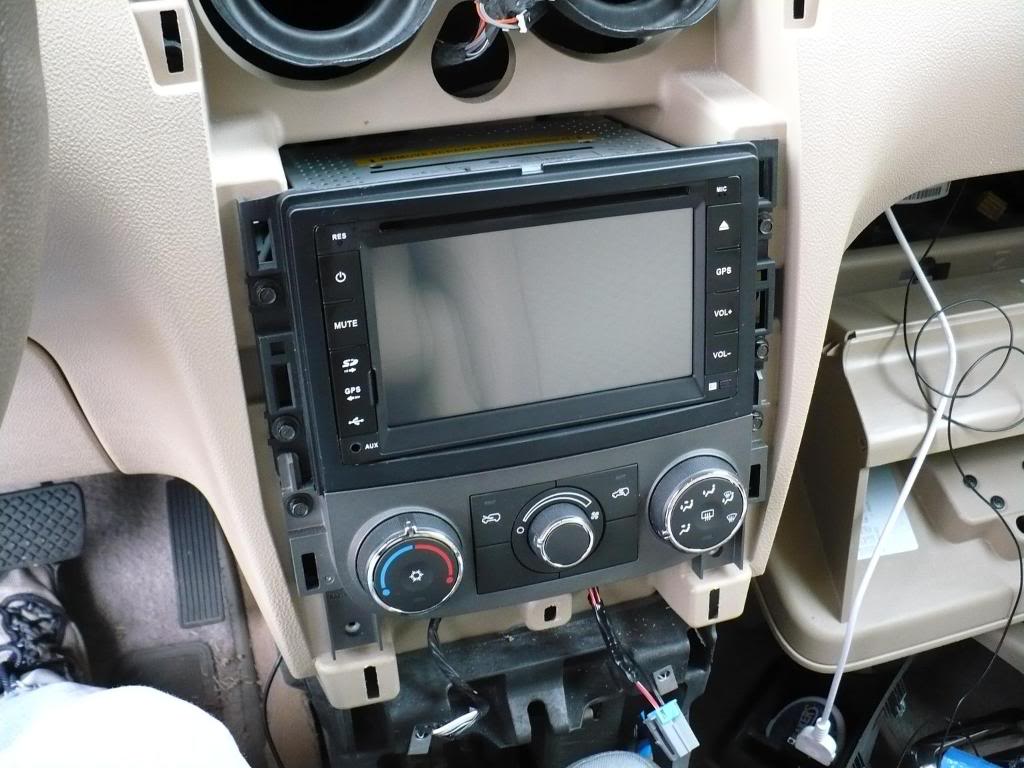

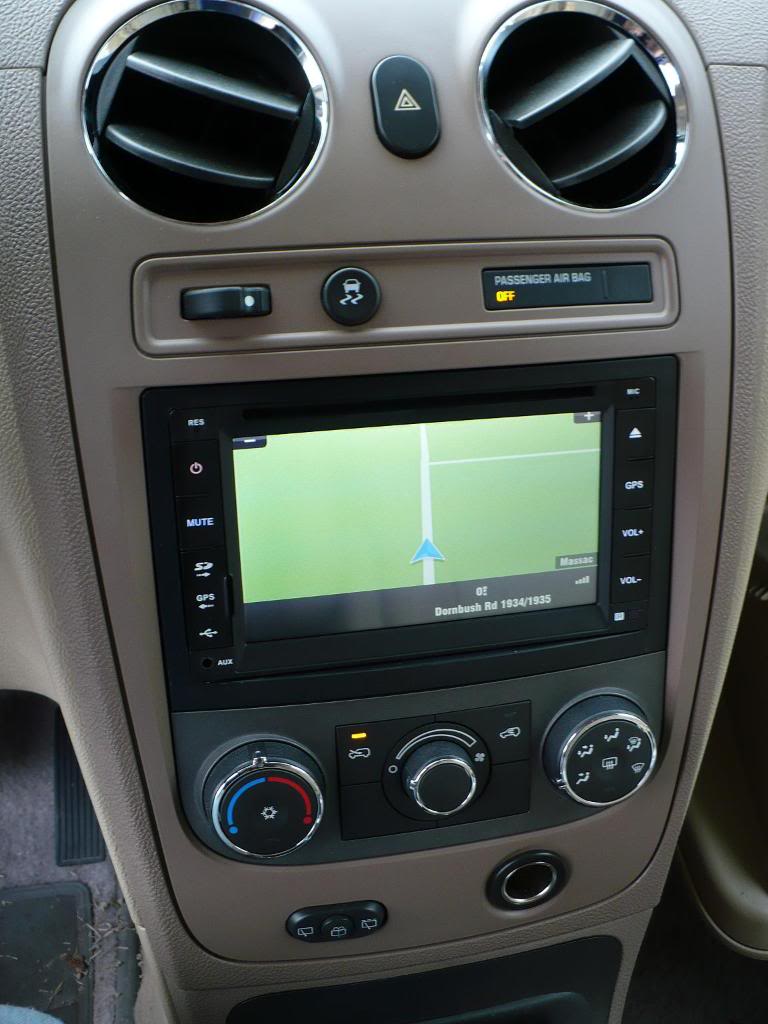

Dash cover is back on and both antenna are on each side of the photo cell. I decided to put the ipod connector in the glove box instead of the ontop dash storage, afraid of heat from direct sun in the summer. Working outside 35 degrees today, so didn't get to the rear view camera. I like the sound of the turn signals through the PAC interface much better than the factory turn signal sound. I have head unit and HVAC controls mounted and the Metra adaptor matches up great. Stereo sounds good, ipod control works great. I turned the GPS on and after first initial loading, it tells me to drive one mile. I'm thinking maybe its part of the calibration, so backed out of the drive and started down the road. It tells me again to drive one mile. I forget that exactly one mile from my house is turn onto next road. When I get there it tells me to turn right onto Unionville RD. Ok, this thing isn't calibrating, it has a destination. theres no traffic around so I sit at the stop sign and program my home location into memory. I go ahead and turn right knowing that in 200 yards is another road that takes me back to my house. As soon as I turn, press HOME and press ROUTE ME, and it proceeds to tell me to take the next right and guides me right back home. The womans voice is good, clear. The map is good. I've never had GPS before, so it all looks good to me. I guess I prolly will convert it to the IGO as mentioned on previous page of this thread.
When i turned the car on for the first time (after dark) and I noticed the screen didn't dim. Then I realized I didn't have trim around stereo on so dash dim control knob isn't hooked up, so no signal to ILLUMINATION feed into head unit. When the GPS accessed the SAT for the first time, the map changed from light to dard background. So with the clock not being set yet, I'm guessing the location of the vehicle tells the GPS program its dark outside. The stereo screen wasn't annoying at night with it not being dimmed, so once the dash dimming feed is hooked up, I think it will be perfect for me.

The store page of the seller showed the unit has selectable led colors and boot up symbol (chevy bowtie option) but I can't find this anywhere in the menu. The head unit buttons have blue back light and don't match the more green looking HHR dash back lighting. If the led colors matched, my OCD could cope better, lol.

Head unit was $249 shipped and it came with all the cables for ipod control, usb, GPS antenna, also came with rear view camera and its wiring.

Dremmel for back of dash to make room/access for wires/cables. Also dremmel Metra 2din stereo adaptor cause either the adaptor or the stereo isn't 2 din. The stereo is bigger than the opening in the Metra adaptor. Soldier and wrap all electrical and speaker connections, added relay per PAC wire harness interface instructions.
