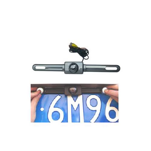

How did u'all mount the back up camera? Looks like it will be in the way of hatch release if mounted on top of plate. No license plate screws on the bottom of plate. I can adapt a way to add fasteners to bottom of plate, but would like camera view to not be that low.
I had a spot right next to the hatch release on the right side of it.

The one that came with the stereo is the license plate mount style. I'm guessing yours is the factory style that tucks up under the bowtie trim (beauty bar i think its called on here). I'd rather have that style.
I just noticed to take that picture, someone is just holding the camera ontop of a long Euro style license plate. I'm gettin a kick out of reading the owners manual that came with the stereo. Very obvious English was someones 2nd language. Use of wrong words, but close enough to figure out what its trying to tell you.

Long day today. Rear view camera install.
I went ahead and mounted it using top two license plate screws.
Removed all the trim panels to run the wiring from dash back to license plate. WOW I hope I never have to do that again. Wish I'd found a factory sub in junk yard so I could have installed it same time. I thougt I was going to have to take drivers seat out just to get wrench on the lower seat belt bolt, but was able to get it without.
The RCA cable that came with the stereo wasn't long enough for me. I ran it following factory wire channels. I prolly hurt video quality by splicing it.
The daylight image looked really good. Night time image was washed out, hard to see detail. I don't think it needs night vision with the reverse lights on.
The stereo head unit automatically switches to rear view camera when shift into reverse. It mutes what ever was playing, until shift out of reverse.
