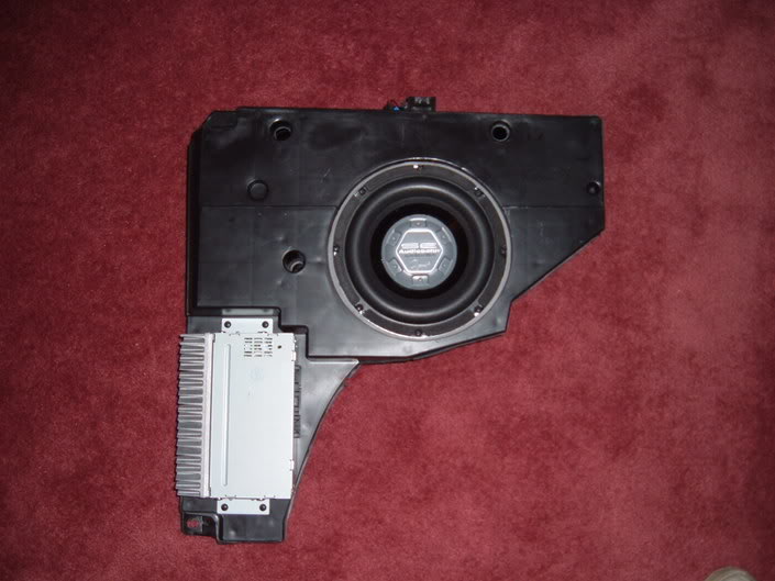

Where is the factory amp located?
Old 01-09-2008 | 07:38 PM
captain howdy's Avatar
Joined: 10-14-2005
Posts: 9,121
From: Rochester,N.Y.
It's attached to a molded in section of the factory plastic subwoofer box. I have a pic that I can post I just have to find it.

On the inside there are some plastic "ribs" that can be trimmed off to gain a little room, but I still had to use a spacer ring. I made one out of plywood. I'm not sure if you can buy them or not as I'm still new to car audio.
You're right stick, I should have gone for more than I needed. It's easier/cheaper to just turn it down than buy new equipment.
@captain howdy - Did you caulk around the sub? Does the stock box need to be completely sealed to sound the best?
Nah. You're seeing the foam strip that goes around the hole on top of the spacer ring. If your using a sealed box like the one from the factory then of course it needs to be copletely sealed to sound it's best.
