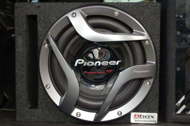

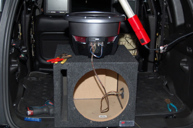

I have been using one Pioneer TS-W3002D4 12 In. Champion Series PRO subwoofer, in a Atrend E12Sv B Box Series 12-Inch Single Vented Subwoofer Enclosure, takes up Alot of room in the back area and hinders hauling stuff in general, and with my added rear seat in my Panel when the 60/40 split rear seat is folded down the sub box slides all over the place in back.
Sliding big sub box has gotta Go and I want Two of the Pioneer 12" subwoofers.

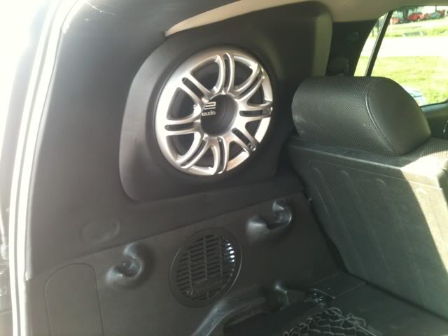

I found a Custom subwoofer install done in another HHR, contacted the owner and he had them custom made at SONUS Car Audio in Clarkesvile TN. Andy2.0 had these made at about a Grand for the pair.
I am gonna try and talk to the guy who made them and see if he will give me some info on how he did them, andy was gonna get me some more pics and some info that he did not post by email, but he hasnt sent them or replied after our initial email.
He must of got busy.
This is what I want to make/recreate.

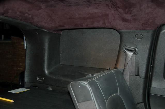

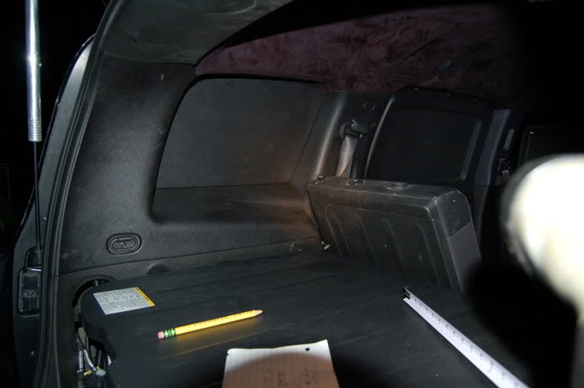

This is the area in my Panel, the Flat area thats 20X12 is removable.

From the looks and from talking to the owner, looks to be a MDF backing and then a MDF Ring mounted off center then fleece stretched over it and resined, add some layers of fiberglass to the inside, and maybe a layer on the outside. and bondo it out smooth.
Originals were covered in black vinyl, and are 10" subs.

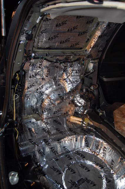

I gutted the interior and sound deadend 90% of the interior roof to floor, doors are done with a layer on the inside outer door skin and then the door is sealed up and a layer on it directly behind the interior door panels, roof and floor are 100% covered, rear spare tire area is 100% covered as are the rear quarter panels.I did not tear the dash out to get in behind it and the firewall, to much work to do that. Huge improvement in the car overall. In the area were the door speakers are I did add a 12"X12" area with 3 layers (4 total overall) directly behind each of the speakers.

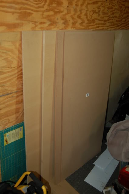

Bought so far for my little project-
Jasper #200 Circle Guide (Amazon)
Hit up Home Depot for these-
1LB. Box of SPAX Hardwood and MDF Screws #6 x 1.5 inches long(nice small heads)
2 SPAX T20 Driver Tips
2- 2'X4' 3/4" MDF
1- 2'X4' 1/2" MDF
-1 2"X4" 1/4" MDF

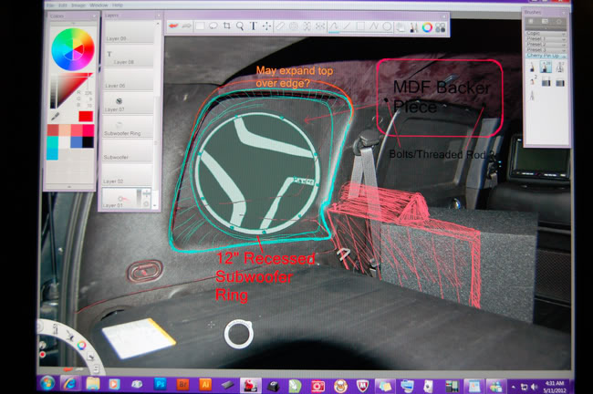

I am rough sketch drawing something up, and will post it with some questions soon.
New to Sketchbook Pro, so it won't be fancy or anything.
I got some ideas, once I post the rough bad sketch i'll run them by you guys.

A very ROUGH sketch here over a picture, just got Sketchbook Pro when I bought my Wacom Cintiq 21UX, so I am learning how the software works.
My thoughts so far on building it are-
The interior panel has a Flat area that GM just added a seperate piece to Cover were a window would have been in the AA5's and the Panels.
Remove that 20"x12" piece (rough dimensions) and that leaves you access to the body.
I'll have to remove the interior panel and remove that flat piece to see Exactly how I could Bolt the 3/4" MDF Backer in place so once the sub box is Completed I can reach in through the 12" opening and LOCK it down, and remove when wanted.
I may be able to add a piece of metal going across the back by either welding or pop riveting it in place and have bolts facing into the box area as a locking point bolting it in place, or, maybe using Large washers, bolt into the side area around were the glass would have been.
The 12" subs are pretty darn Heavy and deep, so I will have to Extend the "Ring" out into the interior space. I'll know by how much once I take some more measurements.
Should the subs Face straight out "Level" facing each other, or most likely will need to be slightly facing towards the rear ?
BONDING - Bonding the Fiberglass to the MDF, Just how STRONG of a BOND does just slathering fiberglass and resin over the top of a MDF piece provide?
Planning on using 3M Blue 2" wide painters tape, to fully tape out the "cubbie" area and fully drapping visqueen plastic sheeting all over top and bottom surrounding area.
Then placing the MDF backer in place and start my fiberglassing out and beyound the rectangle area so it can later be Trimmed down for a perfectly shaped Fit.
Then set the depth and the angle of the subwoofer ring, then stretch my material over the top, resin it, then start layering fiberglass matting on the Inside doing 2 layers at a time, letting it cure/harden and layering another 2 layers letting it harden then another 2 layers for about 6 layers total.
I can then work on the outside top area that will be Seen. Still not sure if I will paint and buff it out, or cover it in black vinyl, or even the matching suede I used on my headliner.
If you Look really Close to the Original, you can see some shaped angles set in the top. Anyone have thoughts on how that was made up?
I bought 3/4", 1/2" and 1/4" MDF.
I was thinking it could be a cutout to fit flush with the interior panels outtter edges, and a layered layer of thin MDF, with the Ring extended beyond that and then the cloth drapped/stretched over the top, then resined?
Thanks
Thanks

Updated my US C. order to-
1.5 OZ. Chopped Strand Mat, 38" wide X 10 Yards
2 Gallons 435 Standard Poly Resin
1 Quart Styrene (Resin Thinner)
4 OZ. MEKP Hardener (Extra besides the included hardener with each gallon)
2 OZ. Surfacing Wax (added to last resin layers to aide in Sanding)
3/8" X 3" Fiberglass Detail Roller
I plan on placing the order Today.
If I end up needing More Resin, I will get it Locally.
I will use 1 gallon of the 435 for each side (Non Waxed) making the first one I will see just how far 1 gallon goes, If I know I will need more, I'll run over to my auto paint supplier and grab a gallon for final coats/layers that will be waxed to help with sanding. At least this way I will have a good quality resin as my base.
And the thicker locally bought resins, I can thin slightly with the Styrene thinner I am buying.
