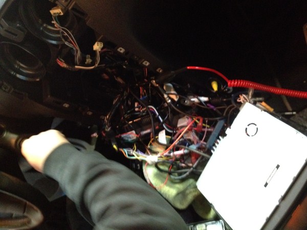

I have a couple of them 04 things, wouldn't work on my car. I bought a pac 11 the third one, worked good. Whistle at me if thats what the book say's u need.

Nice install SS Fan!!! I gues i will have to search and see if i need a GMOS Lan 03 or 04 and I will let you know on the Adapters. Thanks again

Thanks, But I just paid some body, and they were a little challenged by it but it's a sweet running devise now !
not much room in there for the cluster ______, of stuff.

wow you got a lot of stuff going on there
