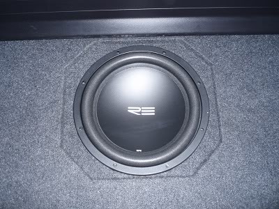

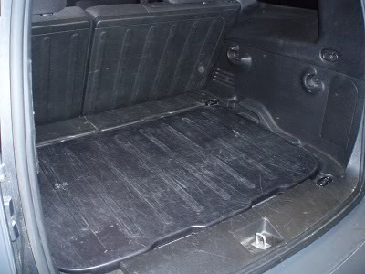

I have my enclosure in the spare tire area. Full size 12" (not shallow). Box is flush with the original tray, and allows me to use the 'shelf' that forms the floor in it's factory position...AND the spare tire is still in place. The ONLY modification is that I had to flip the spare tire over. A portion of my box is built round so it drops into the cavity of the steel wheel.
(I have pics somewhere.....)
Finally found what I did with the pics....
As you can see, the shelf can still be used and does not touch the speaker at all...even at advanced volumes!!
**Please overlook the scuff & scratches...I USE my cargo area**
