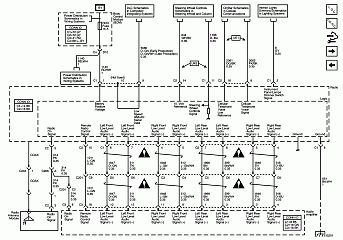

Is the harness made for the HHR. When I installed my Pioneer I couldn't find a harness for my 2008 and ended up buying the onstar adapter. It sure sounds like your wiring is not correct. Your turn on /off lead and others must be incorrect. I'll check and see if I have a wiring diagram for the car when i get home.

See if this diagram will help. This is factory 2006 one for radio.
