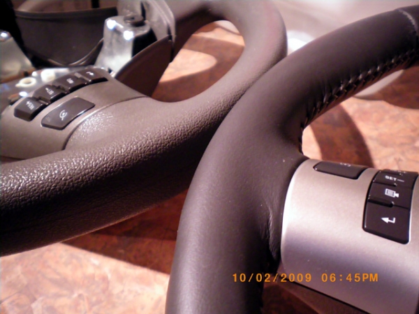

Here's a close-up shot of the buttons to show the difference in height. Also note the grainy texture of the stock plastic wheel compared to the buttery smooth leather:
