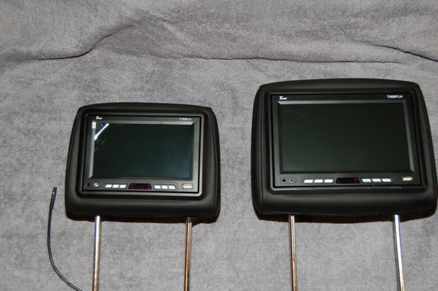

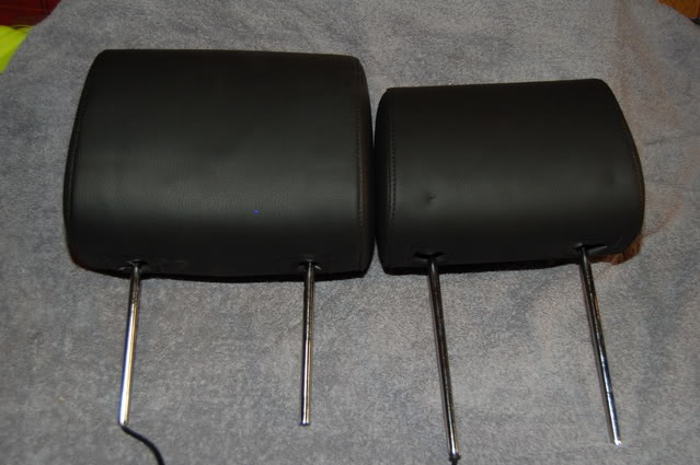

Here are some pics I just took for you to compare the size Difference between the 7's and the 9's.

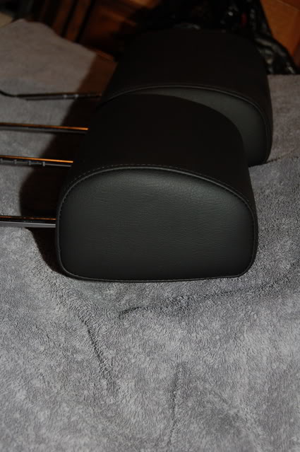

This pic is from last Summer when I was installing the Head Unit and the 9" Monitors, the pic does Not do them justice, I'm NO photographer and just took some quick shots while doing the install.

Love that set up... I went and looked at the ebay store... that dude has a lot of good stuff with REAL good prices... I love the 9" monitors.... are they that much bigger than the stock headrest?.. These are some big headrests...
The 7"s are just about the Same size as the stock oem headrests, so ...
