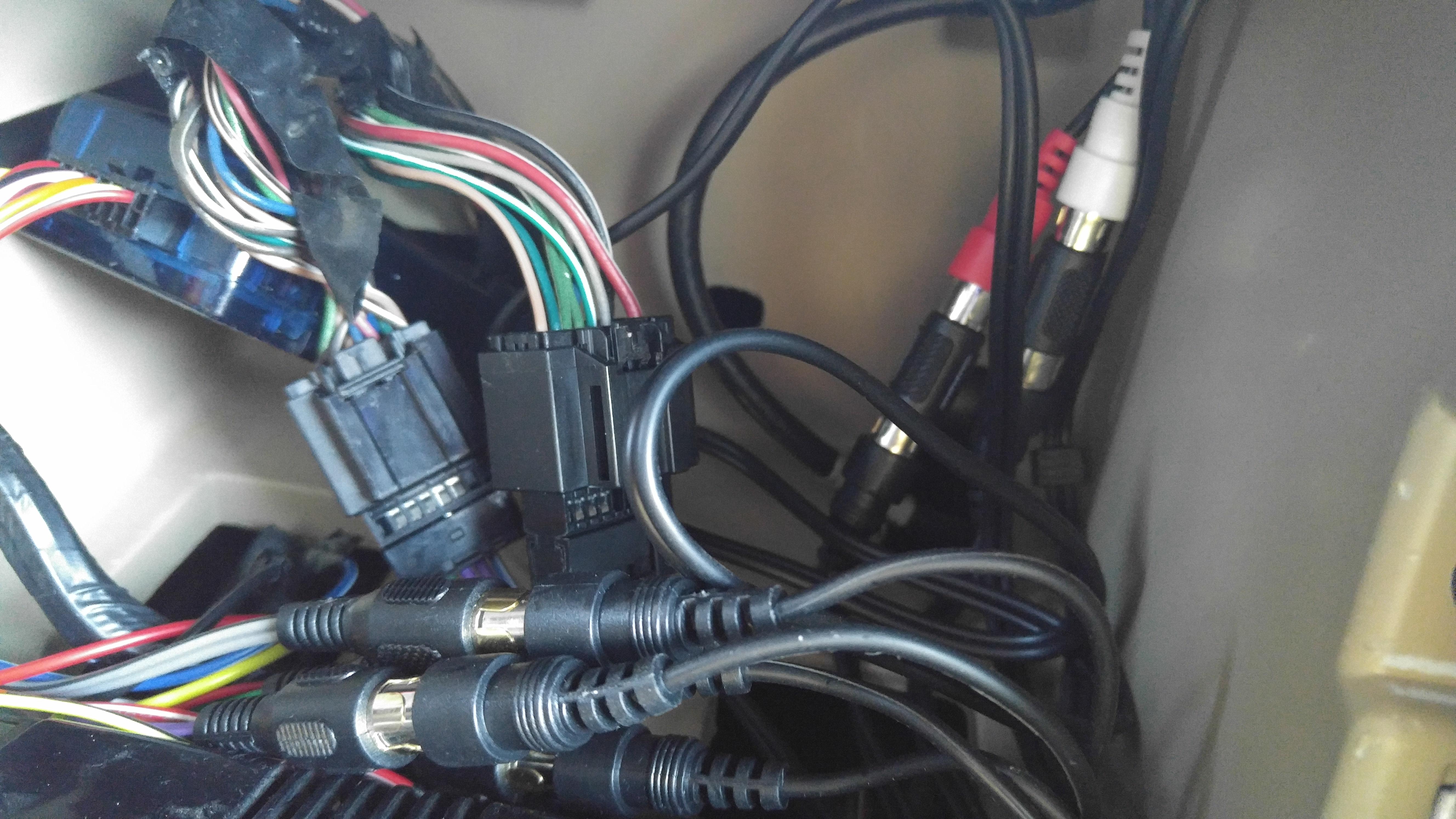

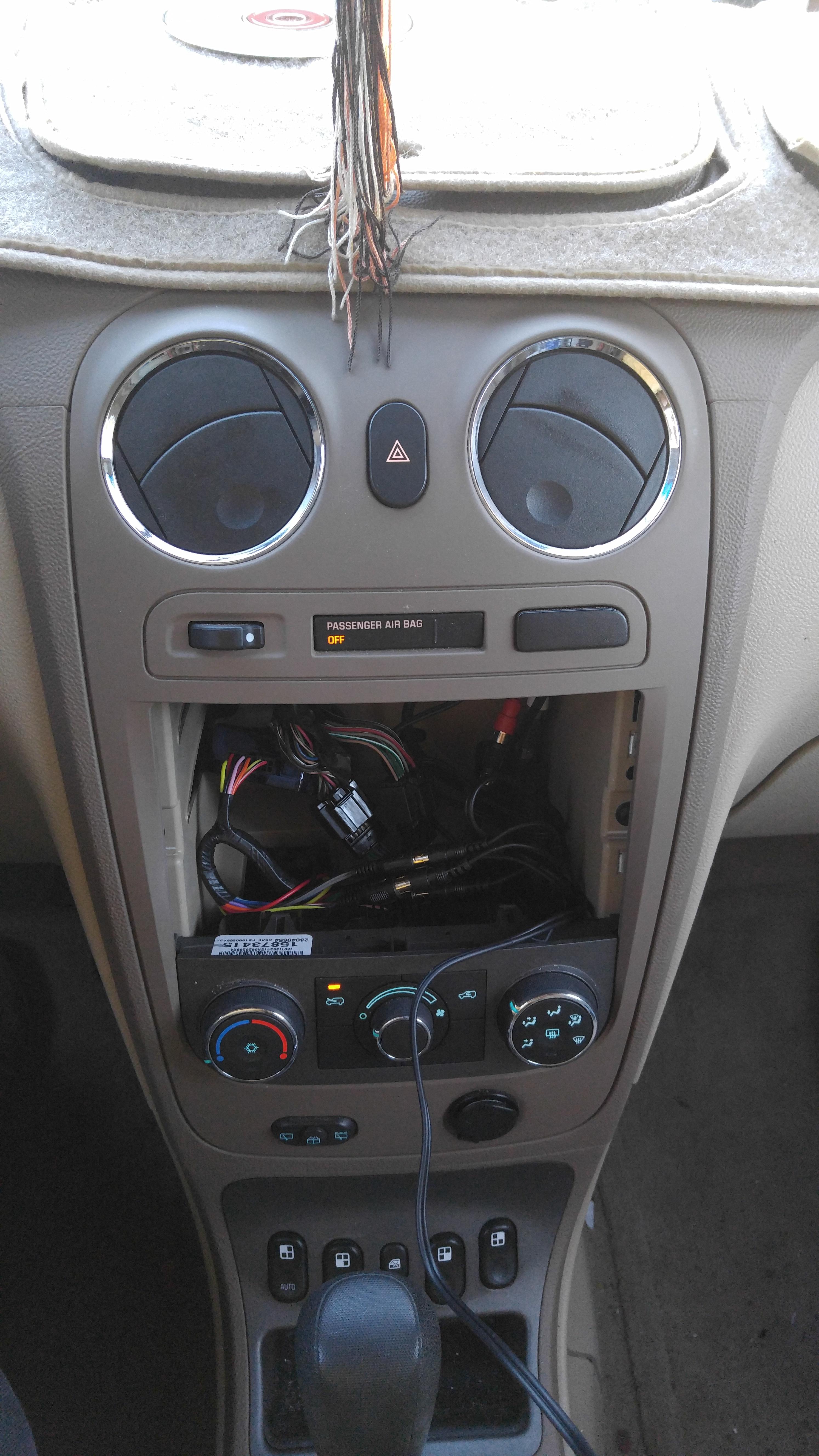

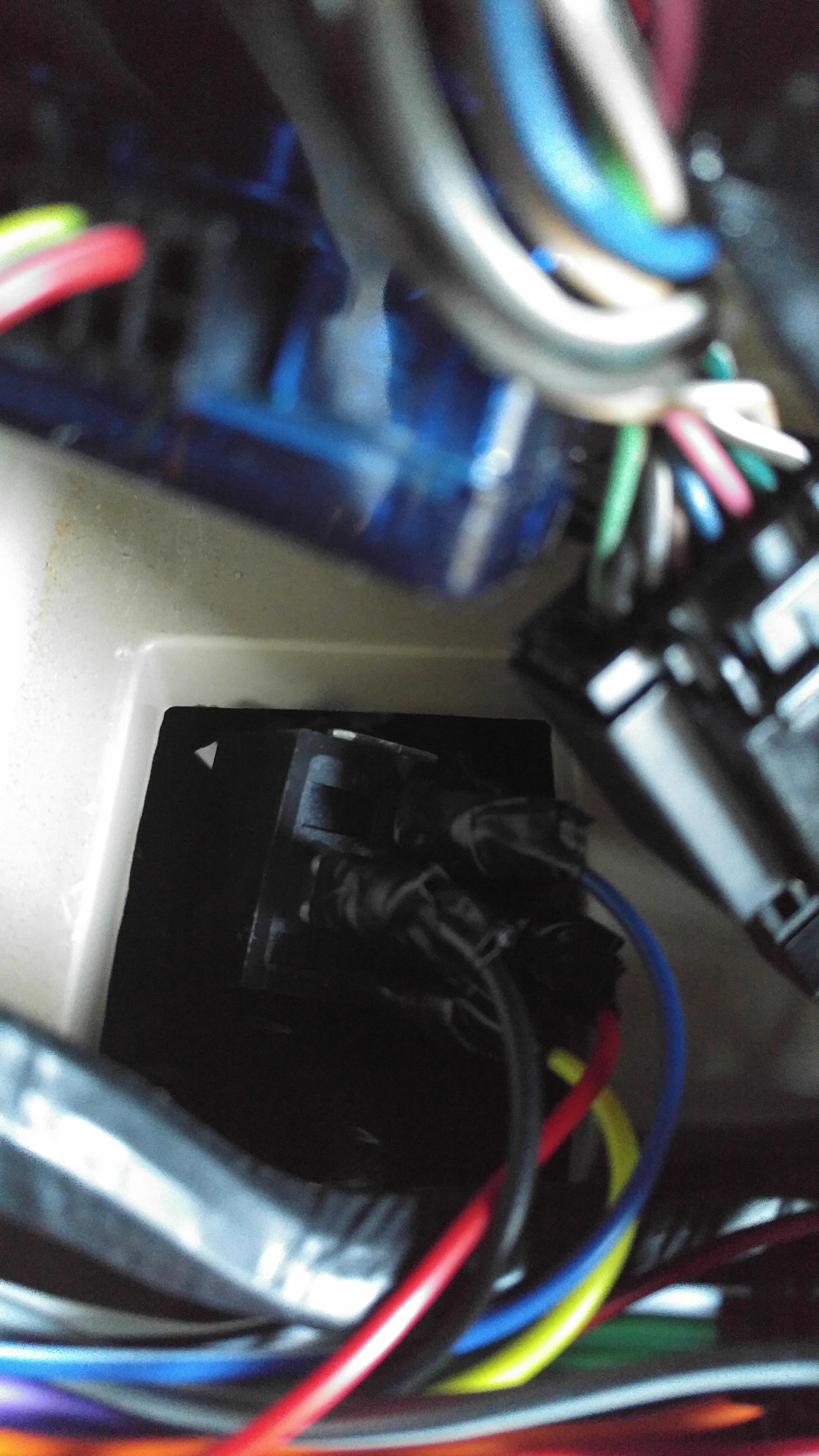

I took the plunge and ordered the adapter. I had to connect the "amp signal wire" from the adapter's pigtail to the 12VDC accessory line to get the amp to turn on (even with the GM LAN bus getting the command to turn on). My a'dapter kit included a relay, so I used that because I didn't know the amperage that the amp would pull from that wire. I just used the constant 12V line (87), the accessory line (86), the ground (85), and the amp signal line (30).
I currently don't have a stereo in place, but I used a 3.5mm to RCA cable, some RCA Y adapters, and RCA couplers to hook up my phone for now. It actually sounds better than the stock HU did IMO (but then, my phone has a 32 bit DAC... :) ).

New hole in the dash:
Adapter and chime box temporary placement with RCA Y adapters:
ACC relay (red is the ACC line, Yellow is constant 12V, Blue is the "amp signal", and Black is GND):
