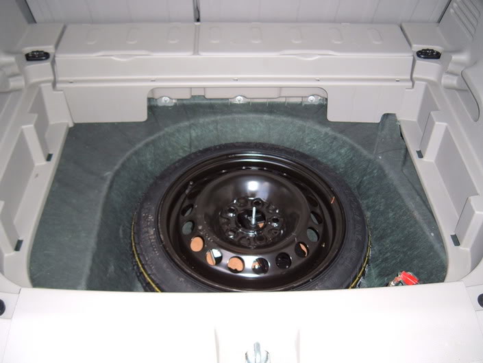

I suck at how-tos so here is a very basic description of how to get the factory box out. First you will need a couple of tools. A small flathead screw driver, a 10mm deep socket, socket wrench, socket extender. I use my hands but you can use a trim removal tool if you want. The first thing you need to do is take off the spare tray and spare cover:

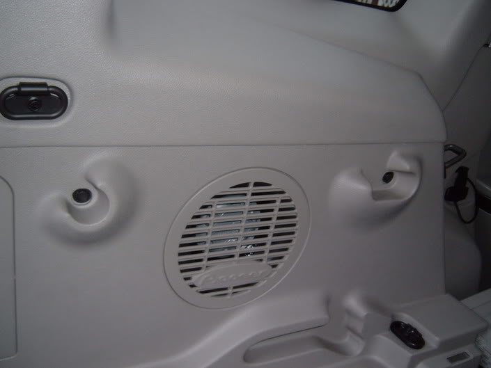

from there you will need to un secure the side panels. Pull the two little pins out of the side panels:
They are two part push pins. Take a small flathead and pull out the center pin:

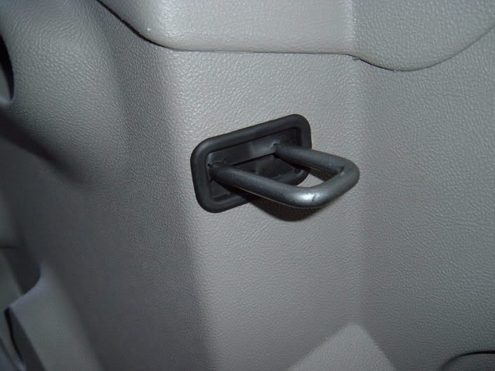

Next take out the rubber gromet out the seat latch:

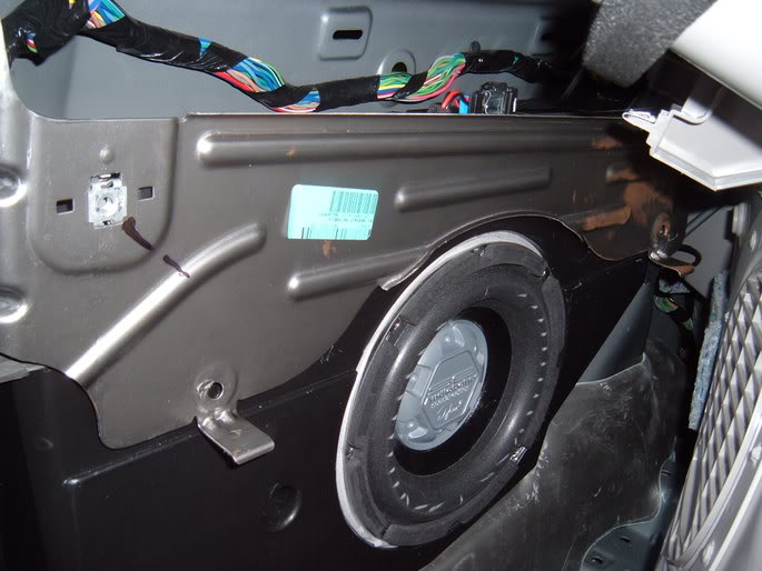

After that you are free to get to the box. It is held in by four 10mm bolts. This in where the socket extender will come into play. Three of the bolts are in the deep holes that go through the box and there is one below the amp:
Once those are out undo the wire harness. There are three plugs on the amp and one at the top of the box going to the sub. If you are thinking of cheating at this point and thinking about removing the eight screws holding in the sub and swaping it without pulling the box, don't even try. The factory subwoofer is actualy bolted into the backside of the box:
You will have to unbolt it from the back in order to remove it. It also leaves a nice little hole to fill in. Also another word of advice is that you are probably going to have to put in a space ring and aftermarket grille like me if you put in an aftermarket sub:
