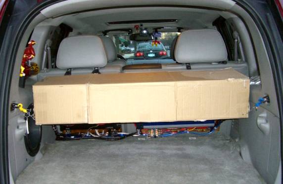

For the record, I was not going to use the 2 same speakers in different enclosures-they were both going into 1 box that was going to fit like this:
This is a cardboard model of what I was going to make. The speakers would fire down, so the top could be used for carring things, as well as under the box. It would rest on a piece of plywood with blocks on each side to fit perfectly in the existing plastic cutouts for the factory tray. To balance the sub, I was going to use 2 cables attached to the box and to the 2 D-rings in the rear of the cargo area. Assuming it didnt rattle, it would be the perfect way of not losing too much trunk space and still having a nice sized box. (Sorry for the crookedness of the photo).

Here is a couple of pointers that may help you out. The key to good, great or fantastic bass is the box construction and not what's in it. A subwoofer box should be rock solid and not be able to move. My fear for your design is that it might be able to move/vibrate up there and that will take away bass. Maybe fit it to the floor and have it fire back (always popular). Maybe a bandpass type box so the subs are not exposed, that way you can set stuff on it and not have to worry about them getting damaged. I can see you are trying to do something different which is cool but you have to be a little careful about what you do or it could lead to just the opposite of what youre looking for BIG BASS! lol My ideas are definately not "outside the box". If you do go with your last idea try to figure out how to really mount that box up there solid (like part of the car solid).

Good point, Tahenke, about the box being solidly mounted to the car. My idea would have it partially attached with cables, so it would be hanging like a suspension bridge. And the base thump would be lost due to vibration. I was trying to avoid anything on the floor since I use the large compartment for storage and like easy access to it. Having a heavy sub on it makes it kind of hard to lift up. But, if I can get good bass out of the Infinity in the factory location, then I wont need any box at all, hopefully.
