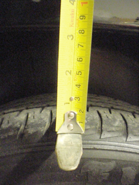

Got my springs installed late last nite. My buddy came over & didn't leave until 11:00 PM. This delayed the project so I started kind of late. Got out into the garage about 11:15pm & finished around 12:30AM. This install took a little longer than usual because I had to take pictures for all my HHR.net buddies. This was distracting at times. Remove a bolt, stop take a picture. Should I take a picture of this? What, my camera needs batteries? haha Overall I would say this was a pretty easy install (for me). I broke a sweat but that may have been the 90 degree heat & camera stress haha. I measured the stock height:
The kit comes with full instructions & I advise you to read & follow only those directions. I am merely posting my install experience for my fellow HHR brothers & sisters. I started by jacking up the rear end so I could remove the wheels. I followed the HHR owner's manual instructions. I set the parking brake & put wheel chocks under the front tires. I used jack stands to secure the vehicle. I removed the wheels.
