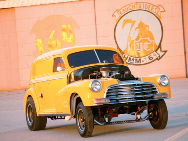

The "sculpted" effect I'm seeing is like what is going on with this 46 Chevy....
Now I know I've also seen this done on a 4 door wagon and it would look great on an HHR...... Note the double molded lines around the panel, all in body color.... would look really sweet.
