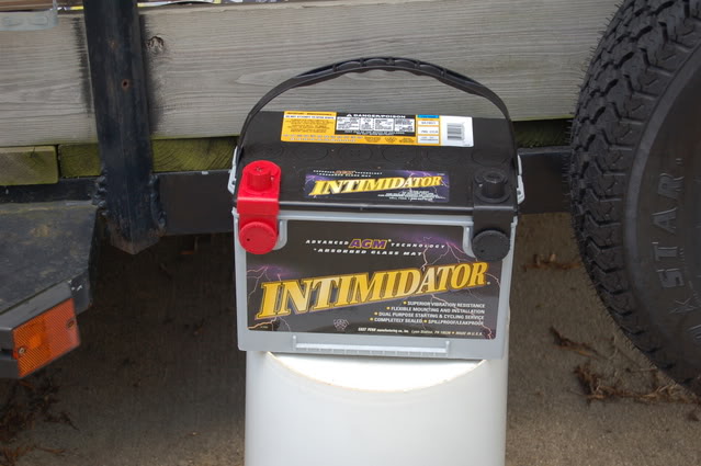

In case anyone was wondering, my new battery has a Black Top as seen in my supplied pic. (I was kinda wondering that one myself since they show it in the PDF and the website as a Yellow topped battery.)
![Name: 4315d93c.jpg
Size: 50.6 KB](https://www.chevyhhr.net/forums/attachments/general-hhr-4/28052d1501210911-carquest-ngt-extreme-agm-battery-4315d93c.jpg)

East Penn/Deka is making some changes to their product line, primarily their Deka Intimidator/AGM line. As we all know, Deka Intimidators have a yellow top. They will no longer be manufacturing the Intimidator as a yellow top battery. Every Intimidator will have a black top.
Remy Battery bought out all remaining Yellow Topped Intimidator AGM Batteries, but they will Not be "Branded" as the Deka Intimidator.
So I guess I did get the Newest version by going directly to the warehouse/supplier in my area. Black Topped has better Specs, than the previous yellow topped version.![Cool](https://www.chevyhhr.net/forums/images/smilies/cool.gif)
I was kinda thinking Hmm did I get the right one, being it has the Black Top, now I know, I did.
