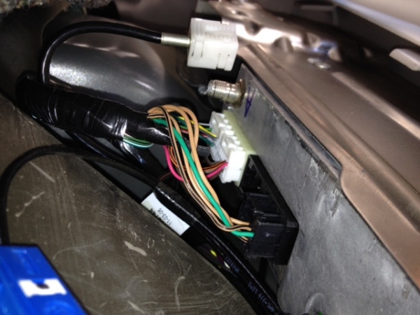

Spent some time googling this topic, and came across many different posts about how to do this and what, if any effect it would have on the car. Some said disconnecting all of it, would wreck havoc, while others said it was not an issue at all.
For the 2007 HHR, the module is located behind the right rear wheel well. It is not easy to get to: you may be lucky and remove the access cover (the one used to replace brake light bulb), but I found it easier to pry down the lower plastic trim piece and pull it out. With the access cover off, you can now see it and get to it fairly easily.
To disable Onstar, you must only disconnect the white plug furthest from the rear of the car, or the engine will not start. If you remove the middle plug (also white) and/or the black plug with brown wires, it will not start.
The 1st white plug (furthest from the rear of the car) has a yellow wire; that is the plug to pull. Once removed, I found that the Onstar button, as well as the phone button would not work. I did not push the emergency button, but I assume it is also non-functional now.
I also dis-connected both coaxial plugs from the Onstar module.
I am personally not a fan of Onstar at all, so that is my reason for doing it. Yes, I lose the safety of the crash-call feature, etc, but having driven 33 years now, I've never been in a situation to need it. To some, that is important, and I get that. But, not to me.
Hello, I did what was laid out in your post exactly, but still get GPS reading on the OBD port. Maybe that is to be expected? I just want to be sure the signal is not going out into the air. Anyway to verify that?
The box is exactly where you said it would be. I unplugged both coax plugs, and the white plug all the way to the front. Car starts no problem.
Thank you! Joe
