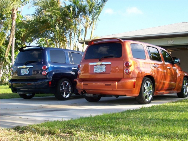

Jack07 - good comparison shot

I got mine from Etrailer, it was the cheapest around. I went with the UHAUL hitch because of 2 reasons, the right side end is not open (hitch is completely sealed) and the safety chain attachments looked alot stronger than the other hitches... with the Uhaul hitch from etrailer you don't have to enlarge any holes or do any drilling. It took me about 30 mins to install and even though my car is lowered all I had to do is disconnect the muffler hangers. There is no trailer hitch on the market that doesnt have the offset look to it (they have to, to clear the muffler). Both sides of the UHAUL hitch attach to the frame rails (or Unibody frame rails), not the spare tire well. The kit i ordered came with everything needed to install except for the tools. when i was looking i researched the heck out of all the different brands and found that the uhaul hitch was the best bet (in my case).. I towed a 4x8 trailer with a 800 pound bike and a car full of luggage and never had a problem. As far as looks, i wished they didn't hang down as low as they do but in my research (and from your picture montage) they all hang pretty low, i actually like it because it's the first thing to hit the curb when i back in so the chrome exhaust tip doesn't get scratched. as far as covering them up, not sure how you do that other than the SS bumper but I'm not sure the car would look right with a low hanging back bumper and no low hanging skirts and front fascia... I know that some SUV's like the gmc envoy, Yukon and Escalade have a flat cover that blends with the bumper, maybe you can get one of those and graft it to your car. Hope that helps.
