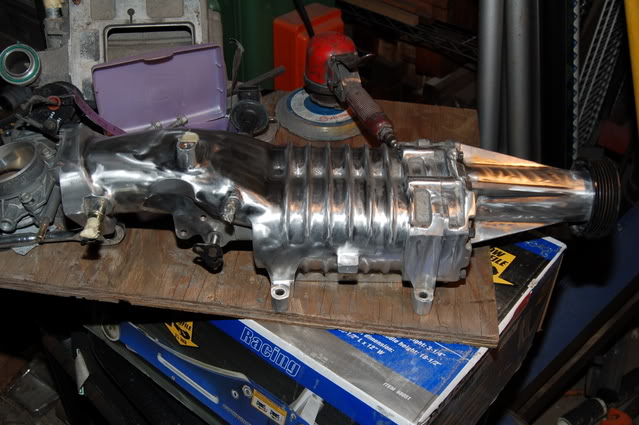

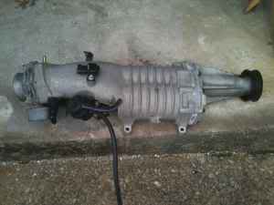

Started cleaning up the Blower (Supercharger)
I decided to go ahead and do it up the Old School way and Polish the hell out of it.
Will be Alot of work and effort, but well worth it. I am keeping track of the hours I have into doing it.
Started on it yesterday for a couple hours and have several into it today.
Should go Nicely with my other Polished Aluminum Items on my Panel.
Several hours of sanding with finer grits of sandpapers to go before starting any polishing. And then that will take Hours to do with 4 different rouges and then polishes.
Before:
During:

Thanks guys,
I got ALOT of work ahead of me on this one. Labor of Love right?
Even with the die grinders and sanders, there is ALOT of hand sanding to do, every nook and cranny Must be sanded down as Smooth as a babies bottom, or polishing will look like crap.
You cant leave a spec in the finish before you start polishing or it will Show like crazy and you gotta start sanding that area all over to get it Rite.
I got AC (if needed) and a 32" LCD TV in the Garage so I just sit on a padded stool and sand sand sand sand sand sand sand.......
My Arms Hands and Fingers are Sore!

Not installing it for awhile so might at well do it up Nice.
Zoops Zoop Seal? Have you used it ever? Out of Stock on their website and not much info on it.
Clear Anodizied ? Maybe, will have to check into it more.
Have you ever had it done?
I am wondering how it could be done, will it effect the Machined insides of a Blower? Or do you have to have it remachined afterwards?
I would think since it's dipped in acid, then boiled in water, the Blower would have to be all disasembled piece by piece to do it?
Not sure yet how I will treat it once fully Polished, I know Paint holds more heat. But Many have theirs painted. My lower intake manifold for the Blower is water cooled with it's own radiator and circulating pump.
I have heard that before years ago about castings and heat VS polishing, but have never found any science to back it up, have you a Link on that?
Just curious, I will Polish it either way, I have seen so many cars with highly polished motors, and blowers, it can't be that much of a problem.
