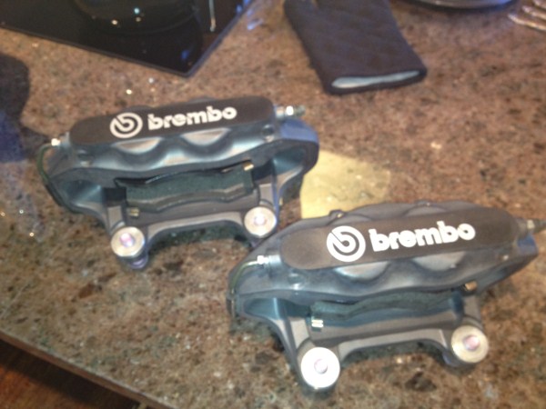

No knuckles , lets see that A5.
https://www.chevyhhr.net/forums/show....php?t=3033%27

Yep, they come with the new bolts, fits right on.
P.S. The Brembos come with their pads on them, I noticed 08 Banshee's made lots of dust so I got the best performance pads they offered, better, but still make dust. They stop so well I don't care about the dust.
