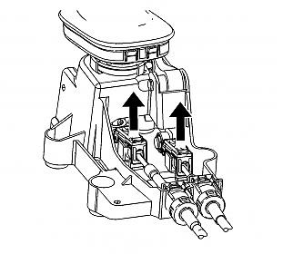

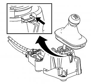

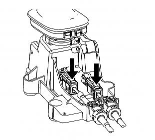

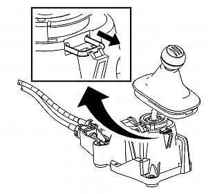

I also mentioned the difficulty shifting into reverse and they said they could find nothing. He said there was no adjustment for the shifter, contradicting what others have said...
I have it up on jackstands now painting the calipers, so maybe I'll have a look-see at the shifter cables myself.
Service Information
2008 Chevrolet HHR | HHR (VIN A) Service Manual | Document ID: 1737736
Shift Cable Adjustment
Set the parking brake.
Remove the cup holder. Refer to Front Floor Console Replacement .
Lift and unlock the shift cable retainers.
Push the shifter neutral lock clip. Move the shifter slightly in order to center the lock clip.
Ensure that the transmission is in neutral.
Press and lock the shift cable retainers.
Pull the shifter neutral lock clip to its original position.
Install the cup holder. Refer to Front Floor Console Replacement .
