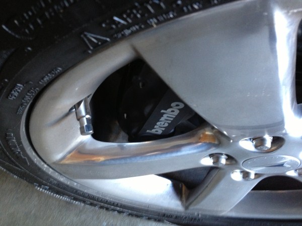

Ha ha, yes I agree with the power level. Now that you have all that go power, what about the opposite ??
These should have been standard on all SS's....the difference is huge.

Yeah I've thought about that. Just did all my brakes and didn't get the conversion kit so I think I'm sticking with stock for now.
