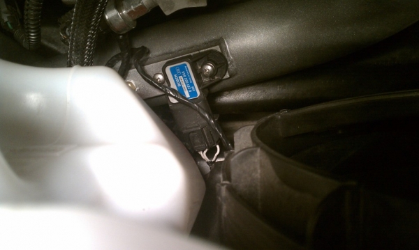

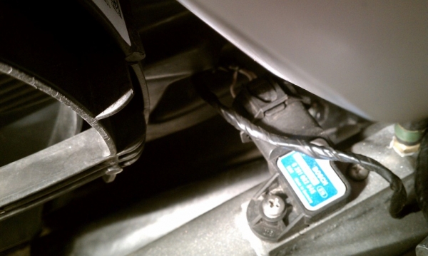

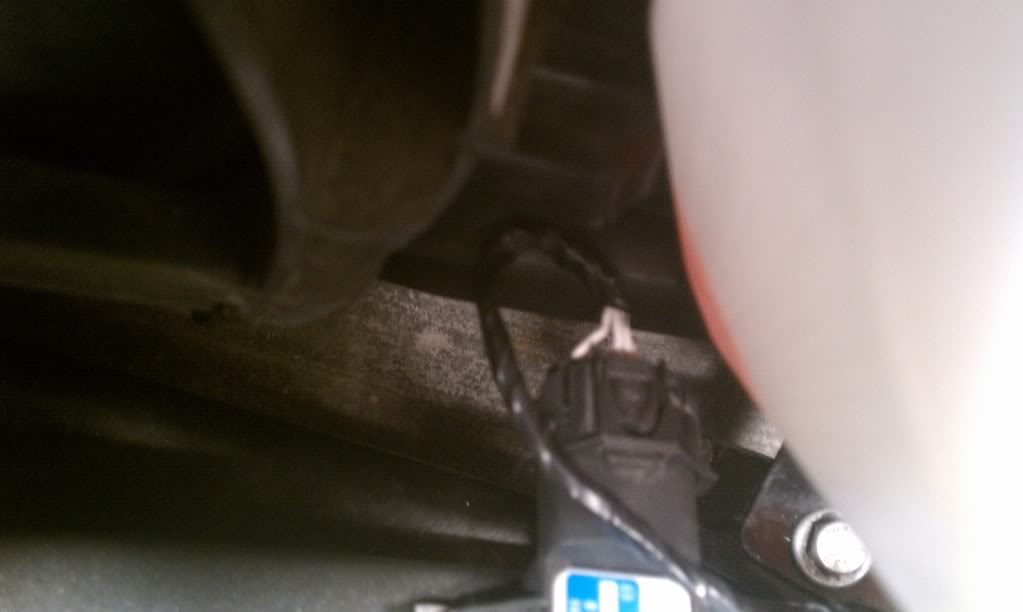

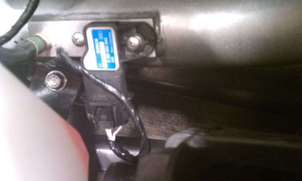

Below are pictures of the orientation in which I installed my lower map sensor. The reasing for its location is because it won't fit the other way. The pipe is mounted pretty solid so I am not able to move it much at all. These are the best pics I could get. It looks like the wires are touching the shroud but the shroud has a 1 inch indentation right where the harness is and there's about one inch between the wires and the shroud. My question is, does mounting the sensors 180degrees from normal position affect the readings at all?? Also am I more vulnerable to hitting the sensors in this position because of the engine movement? Wut do u guys think?

this is the same configuration I went with 3 years ago. still no chaffing, or contact!

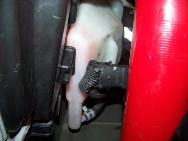

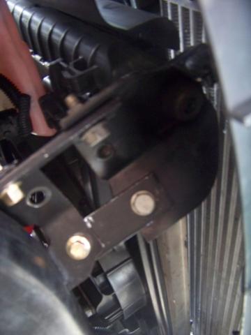

Well "just in case" I fabricated new lower radiator mounts to give even more clearance. In doing so I also created more room in the engine bay. Works very well if I do say so myself. Here is how much clearance I have now...

he is showing the lower T-Map that has been flipped 180* he then made some brackets(like I did) to move the radiator foward just a bit more.
NOTE: this will not work with a CS IC. HAHN and ZZP fit fine with this mod

there are no real upper mounts. you can place a spacer behind the grommited opening to push it out some, but I found the radiator floats uptop nicely.
here is a pic from the underside showing plenty of room
the other pic shows the radiator brackets
