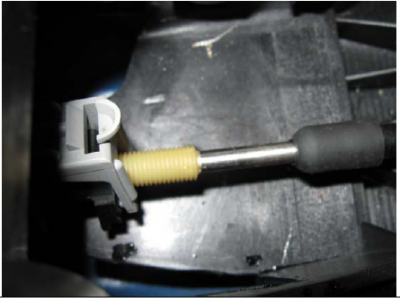

Here are some pics from the TWM short throw shifter instructions that may clarify the parts I'm talking about.
Nylon threaded part at the end of the shifter cable

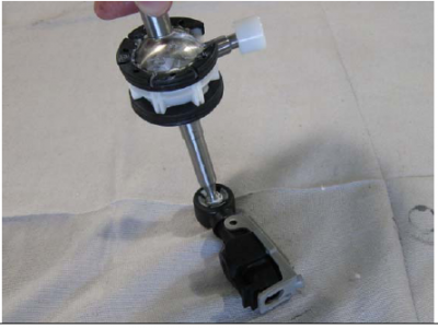

Nylon ball socket attached to the shifter arm ball end

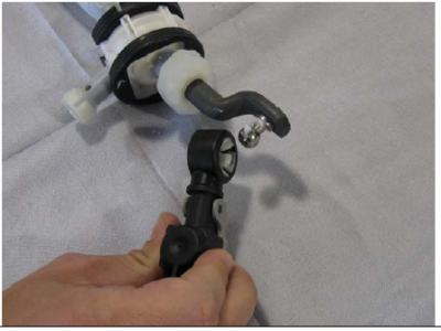

Nylon ball socket removed from the shifter arm ball end

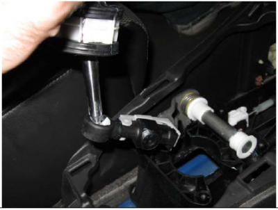

Nylon "weak link" as your inserting or removing shifter arm assembly. This is the piece I would like to design to be more robust
