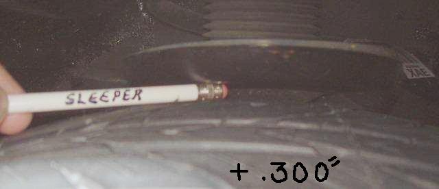

I'd agree, Too Tall.. This pic is of the tight clearance I have with 26.1" tires on..
