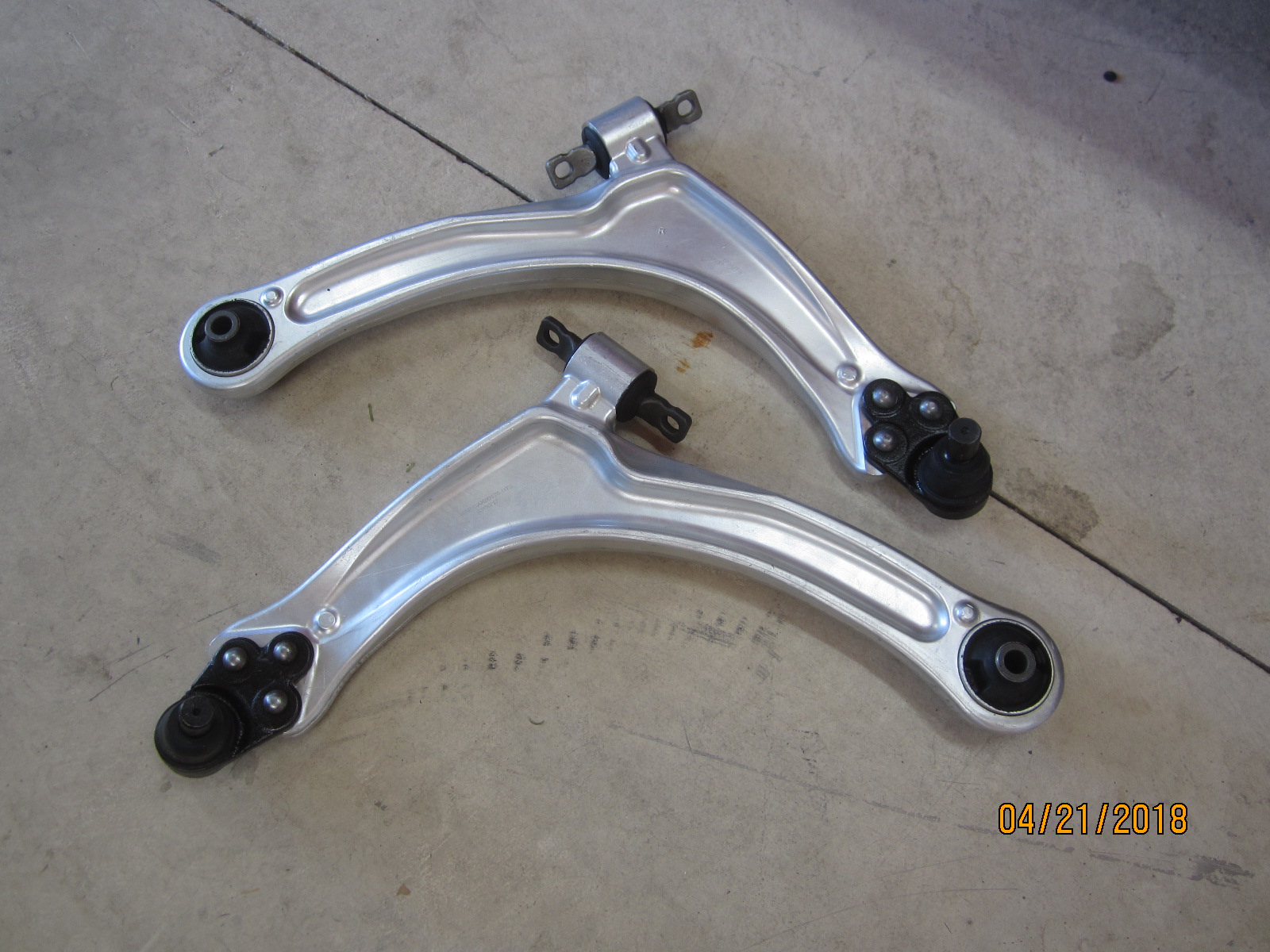

I have a pair of new control arms for the HHR with the FE3 suspension. The bushing inserts are .2" longer than the normal inserts, this is the only difference. These were sent to me instead of the correct arms, and I hear these are hard to get. I paid $125, you can have them for that plus shipping. All components are new- bushings and ball joint. I think these are new arms, not rebuilt.
Shown are the arms before I discovered the inserts were too long.

The rear control arm bushing insert is 56 mm long vs 51 mm for the stock arm. The part number on the package was CAK60175 and CAK60176. Yesterday I read somewhere that this bushing was meant for FE3 suspension. I cannot find this today, so I can't really prove my claim. Attached are 2 photos to show the diference, this way others may be aware of what is available.
Stock insert from old arm, 51mm.
Replacement arm has 56mm bushing inserts, this won't fit on the car. Part # CAK60175.

They should bolt right up, but I could not get the 56mm version to go in. The rubber definitely shrunk, but the steel insert will never change in length. The correct arms went right in, it took 90 minutes for both. The difference in sound and handling is well worth it! I am checking with the vendor to see what car these are intended for, certaily not mine.
