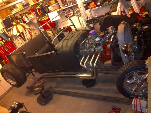

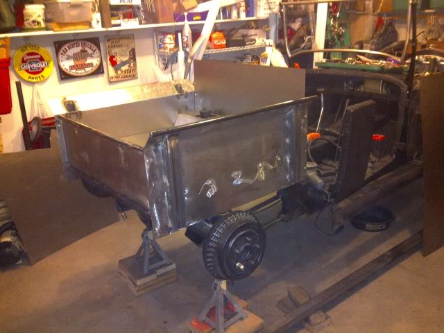

Sides in place.
Tailgate bent and top tube tacked.

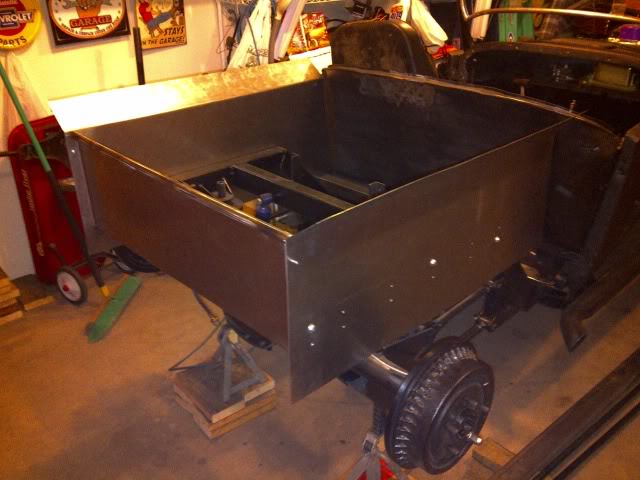

Stake pockets ready for one side, now for the top tube. Tailgate is ready for hinge mounting. I know I was going to go with a wood flatbed but had some 16ga that was begging to be used.
TomsHHR is offline

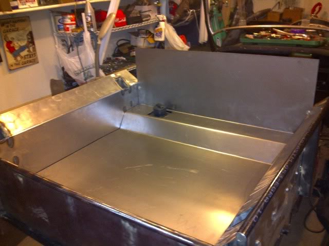

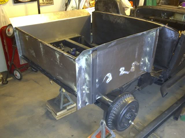

One more bend to front side and some trimming and 2 tubes to go and all of the bends are using 2 heavy angles, the back cross frame and a dead blow hammer..
Floor in the bed, might get wood floor later. Remounted the gas tank forward and lower.
Yes I changed my mind on the bed floor but it still may get a wood flat bed and sides later depending on how this looks finished.

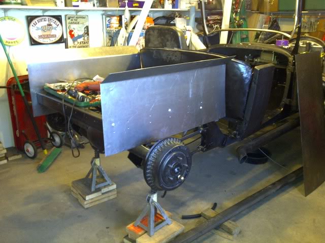

I am told my new seat back panel will arrive in the morning so I can get the front box panel bent and formed to the seat back. I have started on wiring.

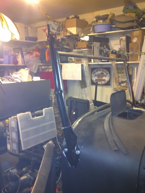

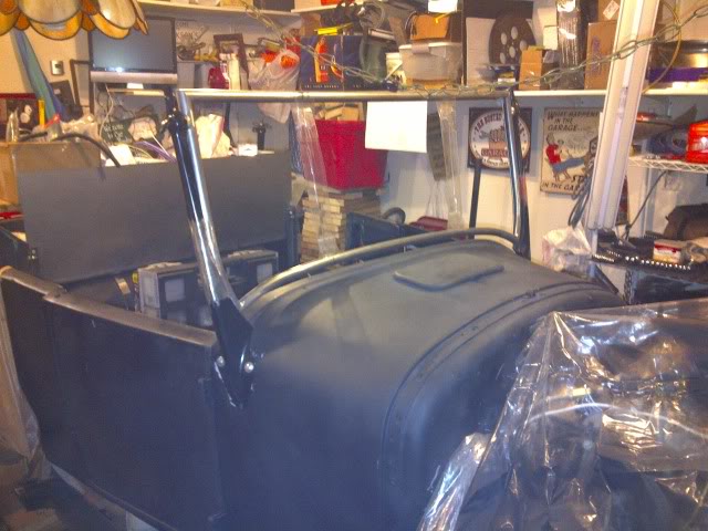

Shortened my windshield supports, note one long one short.
Both done

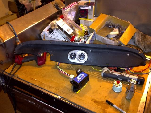

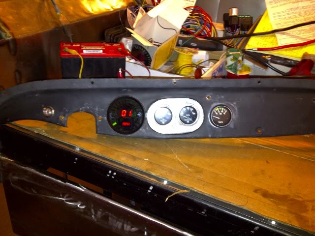

Dash work

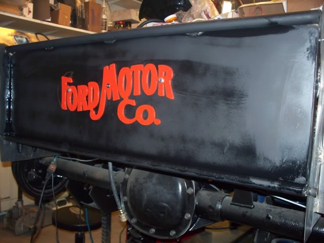

A nice addition Note the Chevy red/orange for the powered by chevy!!

Very Nice Tom............Fomoco in Chevy colors..
