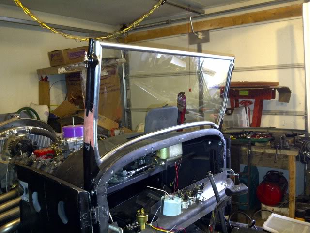

Can you say Windshield installed in frame. Note dash wiring in progress.

Can you say more awesome by the day!

Sweet...... Keep the updates coming!
