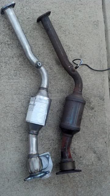

Here is a pic of my stock and aftermarket cat assembly. Cost was under $150 delivered and had a 5 year warranty. Replaced using only ramps and maybe a hr of time. Too easy.
You at your stock cat and see if your upstream O2 is in the manifold or in the downstream pipe. You want to make sure the new one is a straight replacement.
