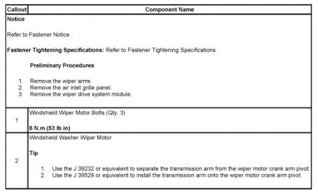

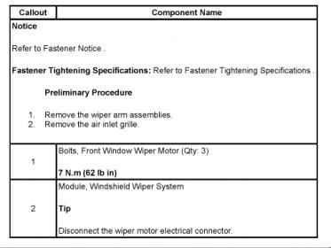

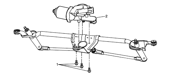

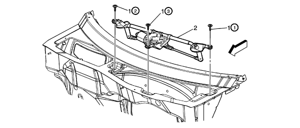

This help? Shouldn't be to bad it pays .8 of an hour. I never had to install one on an hhr

thanks lucky,that is a huge help ,especially beings that i told ford to shove there buyer pays half warenty up there A$$!, that i would do it myself before i paid them half of the $200 labor bill and one ton thanks for the advice,when we sent the car back to the ford dealer they couldnt figure it out and actually sent it to the local chevy dealer and they diagnosed the problem oh and a special shout out to the makers of rain x if not for u i would be walking
