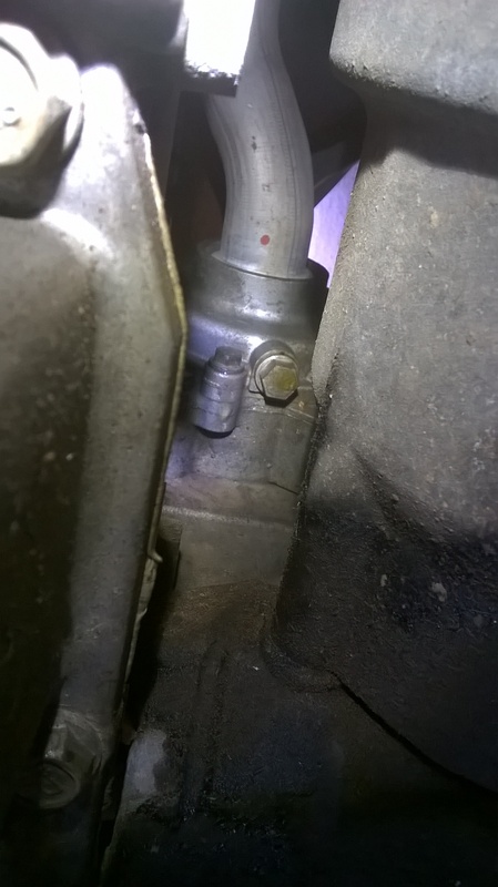

Well I finally found something!
There on that bolt on the water pump you will see maybe two drops of coolant! Plus wetness! Yay.
I had checked this area before, but normally on a hot engine, or a cold one. The only thing I did differently this time was I had the car up on ramps overnight to drain the oil so I could fix a small crack in the oil pan. I was putting the drain plug back in, and my flashlight caught a gleam of something wet.
So now what? Im guessing the water pump has a leak, an external one thank goodness. I gather it that replacing the pump involves a special tool, and lots of swearing? What could a person expect to pay a mechanic to do this?
Old 10-01-2016 | 03:28 PM
  #36
Posts: 37,827
It could just need a little tightening to the drain plug
Old 10-01-2016 | 05:22 PM
  #37
littlehoov's Avatar
Joined: 05-02-2015
Posts: 28
From: Glenpool, OK
Well, the drain plug was pretty tight already, I got it to move a little, but had to crank on it pretty hard. I was just using a normal size 3/8 ratchet, not the breaker bar or anything. I cant imagine its supposed to be uber tight.
I guess I will just have to see if that did anything for it. Thanks everyone for all the help so far.
Old 10-01-2016 | 05:48 PM
  #38
Posts: 25,339
It's not the drain leaking, it's the gasket. Or, the weep hole is on the top and it's a bad bearing (my bet). New water pump. There is a how-to. Found by searching "water pump" https://www.chevyhhr.net/forums/how-...acement-56476/.
Old 10-01-2016 | 11:12 PM
  #39
RJ_RS_SS_350's Avatar
Joined: 05-01-2014
Posts: 8,173
From: California
Torque spec is 16 lbs. ft. and the bolt requires thread sealant. When I removed mine, it looked just like the teflon plumber's pipe dope that I have. That's what I used and have had no leaks in a few thousand miles.
Unfortunately, you'll lose coolant resealing it. Probably whoever flushed your coolant last time didn't put fresh sealant on before reinstalling the bolt.
donbrew, which gasket are you suggesting? I think the drain bolt had a very thin metal gasket on it.
Old 10-02-2016 | 09:09 AM
  #40
Posts: 25,339
The water pump gasket, that tiny O-ring they call a gasket.
But more likely the bearing/bushing/shaft seal is worn out and the weep hole well has filled up and dripping. The design geniuses put the weep hole in a well on the top of the pump, so you can't tell until disaster strikes.
