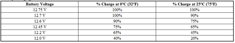

My daughter brought the car home today. On her way home, it acted up 4 times. Three were quick blips and 1 was longer. Engine ran fine. After she came home, she took the car to the store, and it ran fine to the store. However, it wouldn’t start on the way home. She turned the key and the dash came on, but no solenoid click. It eventually started and she made it home (5-10 minute drive).
When she got home, I had her keep the car running, and I looked at the dash and it was dead for many seconds, and eventually came back to life.
I looked quickly for the chaffing wire locations and did see and contact, but I have to inspect more.
I measured the charging voltage it was 14.9 – 15.0 volts (at the engine fuse box) which I thought was high. I cycled the AC and other loads and the voltage didn’t change. With the car off, the battery voltage was about 12.6 volts.

Up to around 19V is acceptable. If something goes wrong with the regulator it defaults to 13.8.
