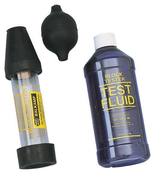

I think the next step would be check for combustion gases in the cooling system with a block tester.
Auto zone sells them and they also rent them.

Rented one but if you remember our coolant system isn't open radiator there's not enough of a gap to run the test it will just suck coolant up no gasses (I tried)
