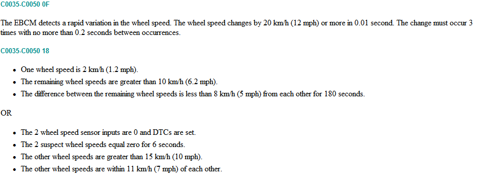

I started a new thread to avoid hijacking.
Tiny differences in the tire will not cause the warning lights.
