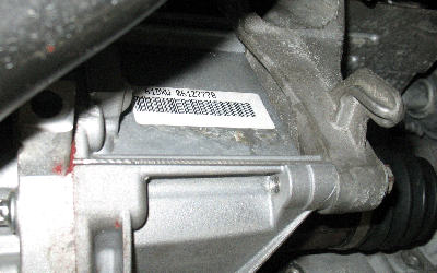

Originally Posted by ChevyMgr
xTooltipElement
Service Information
Document ID: 2257735
#08-07-29-001D: EI08046 - Manual Transmission Grinds in Either Third or Fourth Gear When Clutch is Fully Disengaged (Replace 3rd and 4th Gear Sleeve Hub Assembly, Speed Gear Assemblies and Shift Fork) - (Mar 26, 2009)
Subject: EI08046 - Manual Transmission Grinds in Either Third or Fourth Gear When Clutch is Fully Disengaged (Replace 3rd and 4th Gear Sleeve Hub Assembly, Speed Gear Assemblies, and Shift Fork)
Models: 2008 Chevrolet Cobalt, HHR
2008 Pontiac G5
Equipped with Manual Transmission (RPO M86)
Prior to the Serial Numbers Shown Below
This bulletin is being revised to update service procedure and include additional service parts. Please discard Corporate Bulletin Number 08-07-29-001C (Section 07- Transmissions)
Models
Transmission P/N Transmission Serial Number
Cobalt XFE 24248018 61 YEH 08058387
Cobalt, G5 (STD) 24241747 61 YED 08083169
HHR 24241746 61 YEC 08062188
Condition
Some customers may comment on a grinding noise in third or fourth gear when the clutch is fully disengaged.
Cause
Based on feedback provided by dealer technicians, engineering was able to determine the manual transmission grinding in 3rd or 4th gear. It is possible to correct the condition by replacing the 3rd and 4th Gear Sleeve Hub Assembly, Speed Gear Assemblies, and Shift Fork
Correction
Check the Transmission Serial Number label to determine if the transmission is built prior to the chart above. The Transmission Serial Number label is located on the back side of the transmission between the halfshafts. If the transmission is built prior to the chart above, then replace the 3rd and 4th Gear Sleeve Hub Assembly, Speed Gear Assemblies, and Shift Fork.
Parts Information
Part Number Description
89060051 HUB ASM, 3RD & 4TH GR SYN
93321261 GEAR ASM, 3RD
93321267 GEAR ASM, 4TH
93368559 FORK ASM, 3RD & 4TH SHFT
19207672 RING, BLOCKER (Qty 2)
My better half's 2009 HHR grinds going into 3rd and 4th, the dealer says it's normal. I will have her take this with her on the return trip. I also think the throwout bearing is bad. I can feel it vibrating when I push in on the clutch.
ChevyMgr,
How can I get a copy of this, or direct the dealer to this information?
