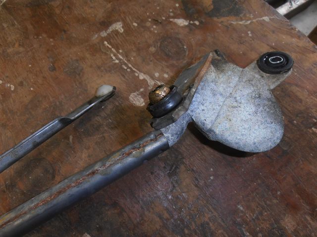

so, the arm fell off, it appears that it is a ball joint type and a plastic part inside the ball socket sheared off....... it is actually back together and working currently, but the only thing holding it together is the rubber grommet seal, so it is only a matter of time till if falls apart again...
is this the bushing that you mention badass ???? it does not appear that it is made to come off the arm ????
i would have to take the whole mechanism with the motor to see underneath it and determine how the arm is helf onto the cam.......
worse comes to worse, it appears that i can drill a hole thru the ball joint knuckle and hold it together with a screw and nylock nut....
thoughts ??

fixt
well. i figured that i needed to get this fixt before winter plus the mrs was getting perturbed having to look out the windshield full of rain and splattered bugs.
i couldn't find any bushings to replace it, ..... so i had to improvise.....
LOL,
yea, i only keep stainless hardware around the shop, i keep a magnet in each bin to make sure.....
the diameter couldn't be much larger because of the way it all goes together, there is no way that it will ever shear off, there is not really any force on it in any direction....
i just used what i had laying around, normally i wouldn't have used a flat head (or if so, i would countersink for the head) but i didn't have any pan heads of the right length,,,and it didn't seem worth the effort to countersink,,,,,i searched for a nylock but didn't have any in that size screw..
i did have some nuts with the star washer built in, but that wouldn't work becasue the rubber grommet acts as a spring keeping everything tight without binding.....
i have a harware store within a half mile of my house, and could have done it nicer for a couple bucks............. but no one will ever see it............
works like a charm on rain, soon i'll see how it holds up to snow, and whether there is going to be extra wear in the ball & socket....
