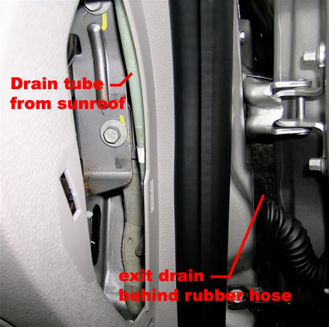

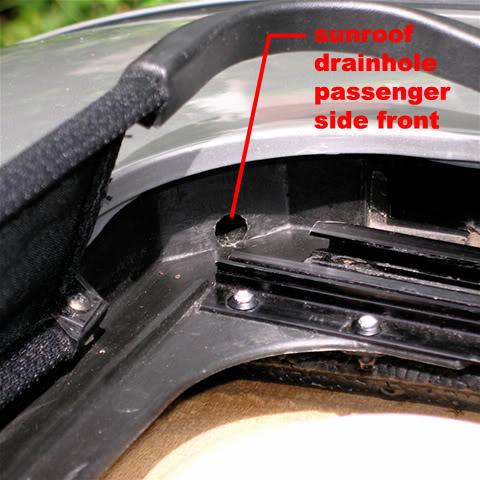

As I poked around, I found this useful posting. Are there one of these holes at each corner? In the second pic, is this a split picture of two side by side? Is a panel removed in the left of the pic, which shows the tube? If so, where is this oriented? Thanks.
Joel

The bottom picture is on the passenger side with the door open and the access panel on the side of the dash removed. It's not a split picture.

Thanks db/sb, but this brings up another question. Explain what the "exit drain" is on the right side if it is next to the "drain tube" on the left in the panel? Are they not related?
Joel

Basically it is all one line that goes from inside to an exit outside. Here's a picture. Just follow the red broken line.( I'm no computer artist).

??? Not sure what doesn't look or sound right. It's very simple. The water drains from the sunroof to the "inside" of the car, down that plastic tube. At the point shown in the picture, the tube turns and "exits" or goes through the A-pillar lower area. The water is then drained outside.
The picture posted is what you will see if you remove the right dash end cover. Like I said. It is very simple.

I finally had the opportunity to physically take a good look yesterday. I saw the holes up top at the sunroof channel, and they were clear. I popped off the side panel of the dash, and saw the drain tube, and saw how it turned to the exit port on the side of the door frame.
For some reason, I was led to believe the drains went to the underside of the car frame. For the front drains, they go to the side as shown above.
My next question is this. I cannot see the rear drain holes up top, nor see how they drain. Are there any pics of them? If they are set up the same, do they go down the B pillar between the doors? And do they go all the way to the bottom underside of the car? I did not see a similar exit point in the rear door jamb.
