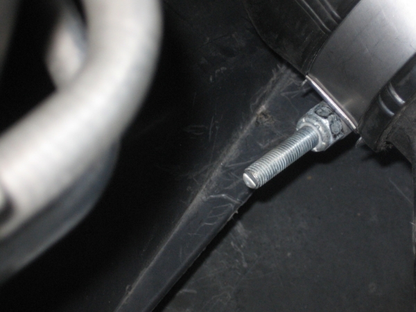

update & assumptions.........
the following text is based on TOTAL ASSUMPTIONSand not fact, so take it as it is and nothing more. With that being said here are my conclusions for my recent codes and loss of boost on different occassions.
I do have the Hahn BSR tune, and in the beginning I was getting up to 25 lbs of boost or slightly more, now the highest I get is 23 lbs of boost when all is well,and that is when I hit passing gear, but then again, not having my foot into it @ WOT from a stop as much as before. I need to do more WOT testing from a standstill
In the past I have noticed that when I have had boost problems, a tighten of the clamps would seem to cure the issue. And of course the bottom clamp coming out of the IC on the driver's side was always a PIA to get to and tighten. So in the pic below, you can see that I rearranged the T-clamp so that now all I need to do is open the hood, get my socket and rachet, use my left hand to slide down and tighten. So much easier. Since I did this on Saturday, the SS is running just fine. Now I am not saying that this the answer to the two codes that I have seen, but it sure has helped. I don't think I was getting that clamp as tight as it needed to be, but now it is a breeze to adjust.
My thoughts on the P2261 code is that if you are feathering the accelerator and only getting partial boost and then letting off, as opposed to hitting the passing gear completely, this may have the valve open and close in such a way as to get stuck if done repeatly, because you are not totaly following through in your intent.
My thoughts on the P0234 code, is that after reading further on how to check the vacuum tanks and connections for leaks, leads me to believe that any air connection not fully tighen may cause this condition.
Now looking at the A/C compressor and seeing how the connector is very close to it, it is understandable to see that upon the torque of the engine that there could be something that would hit or press up on the connector to cause a problem, as I have heard a clang on occassion, so that needs to be looked into further.
So far so good, no codes, but I wil test more to see if the codes come back again. As of now the BOOST IS GOOD.......I am happy......Tom

today's update....
since the weekend, I have been trying everything possible to set the codes and lose boost on the SS to recreate the previous conditions. last night on the way home, did at least a dozen partial and WOT passing gear maneuvers, and yesterday and this morning, pulled two hole shots at the light trying to torque the engine as much as possible. result........nothing.
I will continue trying and see what happens. Today's assumption is that I also used a long screwdriver to lightly try to move the connector away from the A/C compressor on Saturday, and also tried to make sure that no wires, cables or anything else was near any moving parts.
I also still believe that making sure that the IC tube is tighten securely at the IC is a big plus. My boost still pegs @ 23lbs, and I can still light up the tires at partial throttle, which I haven't done as much as before. I have also made RH turns from a stop and hit it a bit, just to torque the engine as much as possible along with body movement in a different direction to achieve the previous outcome, but no luck
Then of course if I do set a code in the future, or lose boost, then these assumptions are just what they are....assumptions......
