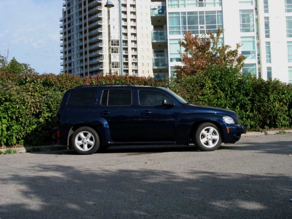

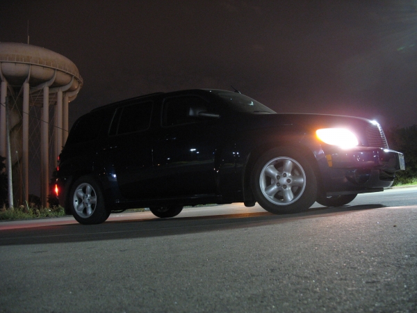

The rims look great, i have a set of the exact rims and were going to see what they looked like on my Black Granite HHR, the only thing i don't like is the Cadillac emblem in the middle, can't see what you did from the posted picture. Any ideas?
