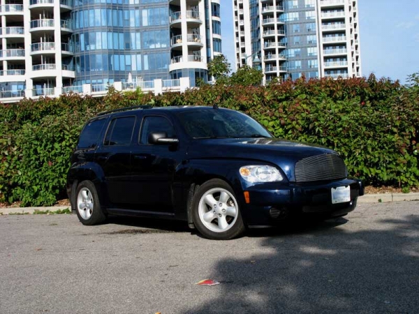

I went for my own version of a retro look using cadillac wheels though, and as my tires will be worn out next year, I will be going with bigger ones to fill out the wheel wells a little more.
